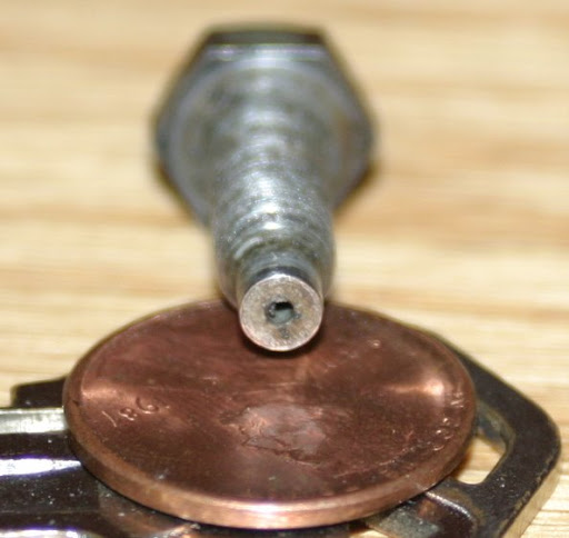

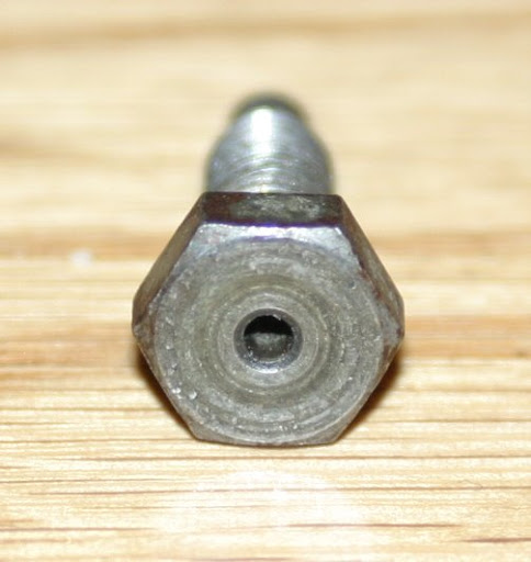

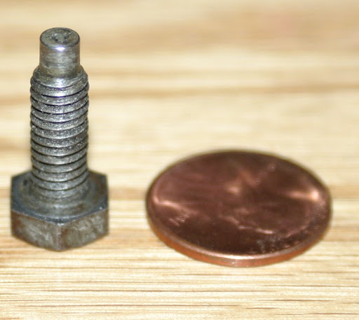

Going through my loose nuts and bolts and I can't place this bolt It might be for another project but wanted to ask you guys here since you have more experience on these engines. bolt is about 3/4 inch long and has a hole through it.

This bolt hods the negative cable and speedometer drive bushing at the rear of the gearbox. The gearox only has a few threads to engage the bolt-don't put much torque on it.

The reason for the hole is to allow the transmission to vent. Without the hole, it will push grease past the seals.
