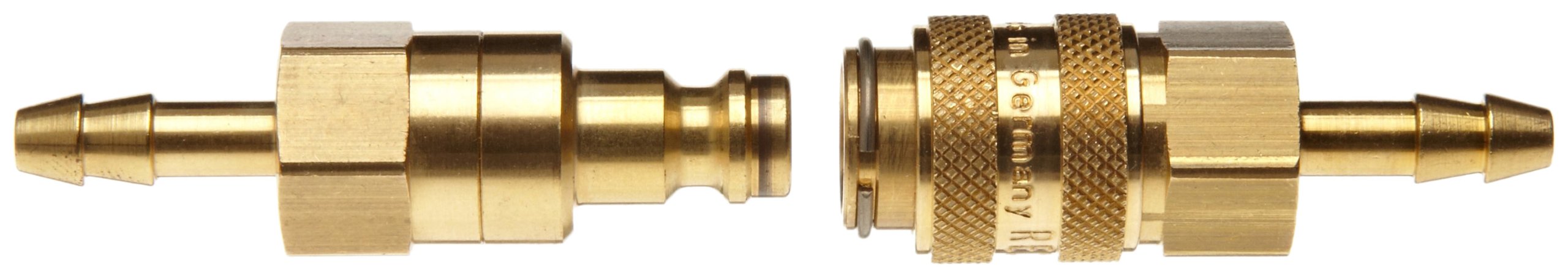

    Day Dreaming ... happy wanderer's Avatar
    Mar 2010
    Vancouver, B.C. Canada
    1,814
    My current quick disconnects are not OEM. They came from a place called SmallParts.com which disappeared and is now an Amazon Supply store. For some reason they don't carry the 5/16" version anymore.
    They look like this: http://ecx.images-amazon.com/images/...ef=sp_dp_imgzm
