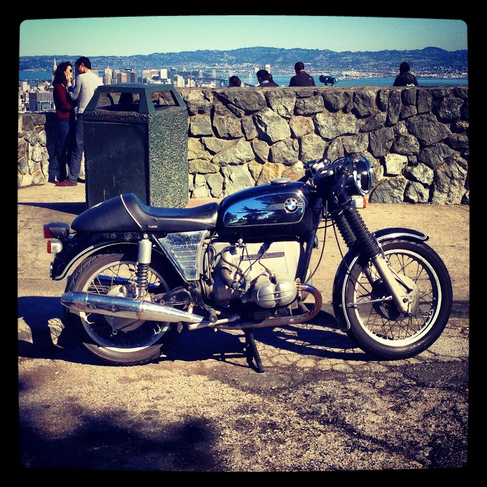

    Here is a quick pic of the bike up at Sutro Tower over-look here in SF. It was the first place I took her.
