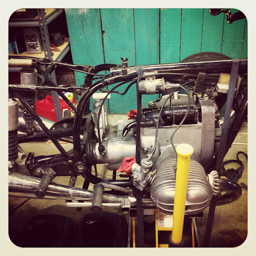

    I had a small issue getting the drive shaft bolts off. I did not have the factory box wrench, and the two 10mm 12 point wrenches did not have enough clearance to get in there. I ended up grinding one down a bit, and it got in there without issue, and was really easy to remove once I can get a grip on it.
    (I love how these bikes look stripped down)
    The old bolts are the short type, the new ones I got from BMW are the longer ones, and I believe these medieval looking washers go along with them....am I correct? will I have any issues with these longer bolts along with the locking washers?
    After that I removed the clutch linkage, and neutral indicator wire. The transmission lifted right out, I left the kick starter and leaver attached, even with the carbs still on the bike there was plenty of clearance to get it out of there.
    Its pretty gross, going to be nice to have the opportunity to clean it really well.
