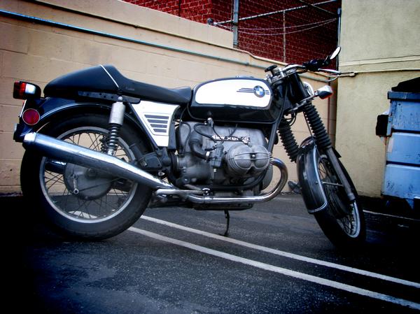

    But I feel ready now, and I have a great garage, and really really really miss her.
    here she is about a week ago:
    I charged up the battery and topped off the oil. The battery did not have enough juice to power the starter, so I kicked her for a while, and with the aid of some starting fluid she would turn over and sputter, then die. I think this is a good sign. Next I replaced the gas with new fuel, and swapped out the plugs. Same effect, just some sputter here and there then she died. I knew going there was a very high likelihood I would need to clean and rebuild the carburators.

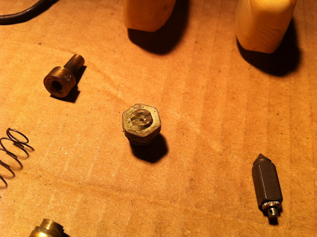

    here is a picture of what may be one of the many reasons it was not able to fully start:
    I broke them both down, o-rings were shot, there was a lot of varnish build up in every hole etc. I blasted everything with carb cleaner and worked them with a tooth brush, then gave each side a 1 hour bath in chem dip, washed everything with water after.
    and put them back together with the old gaskets / orings / etc.
