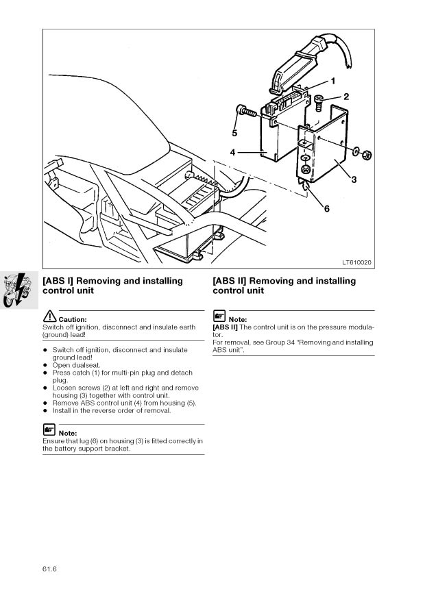

    Unhappy Change the battery in a K 1100?
    I tried to follow the instructions in the manual, but the pictures in the manual don't seem to match what I see on the bike.
  2. #2
    Sep 2007
    Virginia
    53

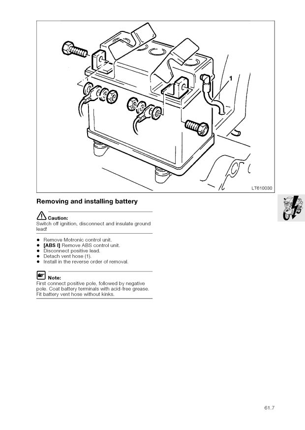

    Here are the two pages you need:

    Thanks
    Thanks for taking the time to scan the pages and send them. I must have the wrong manual for my bike because the pictures you sent match what I'm seeing on my bike. I'm going to try to remove the battery tomorrow.
